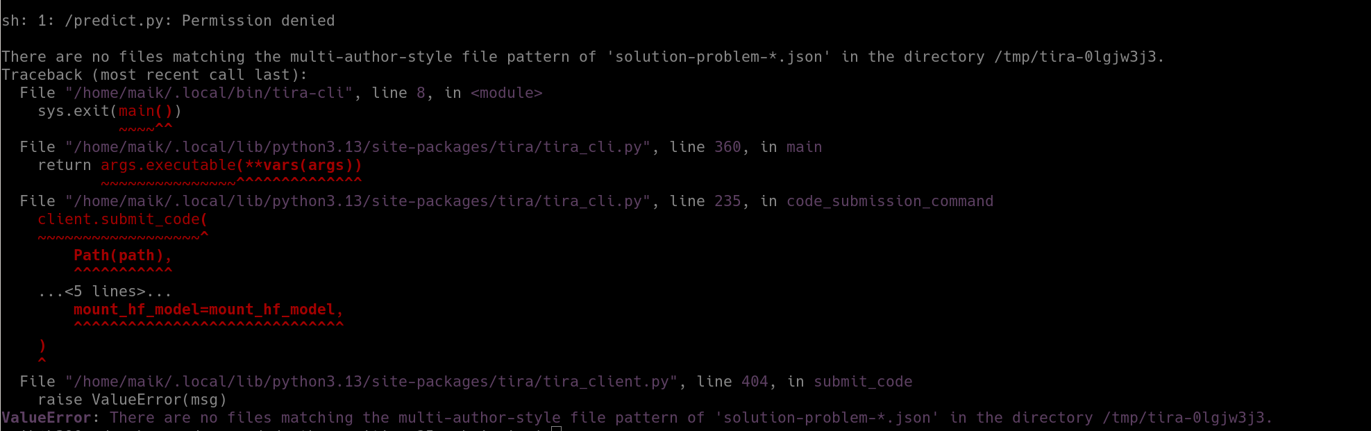

I now have it, there was an error message above the traceback:
The sh: 1: /predict.py: Permission denied indicates that the file is not executable.
You can resolve this via:
chmod +x predict.py
After this change, everything seems to work, i.e., the software makes predictions.
(update: i just committed the modified permissions to the git repo, so it should be resolved)
Does this solve your problem?

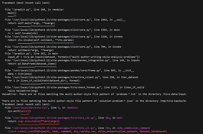

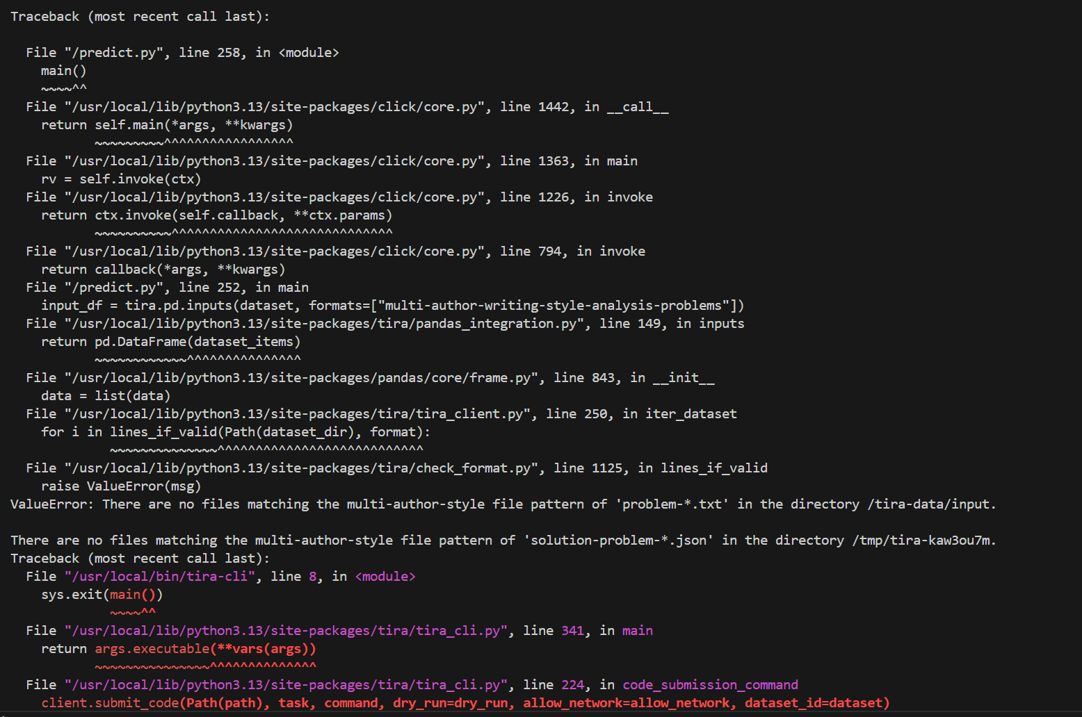

Unfortunately, I am still encountering an exception when doing a dry-run:
Traceback (most recent call last):
File “/predict.py”, line 279, in
main()
File “/usr/local/lib/python3.13/site-packages/click/core.py”, line 1442, in call
return self.main(*args, **kwargs)
File “/usr/local/lib/python3.13/site-packages/click/core.py”, line 1363, in main
rv = self.invoke(ctx)
File “/usr/local/lib/python3.13/site-packages/click/core.py”, line 1226, in invoke
return ctx.invoke(self.callback, **ctx.params)
File “/usr/local/lib/python3.13/site-packages/click/core.py”, line 794, in invoke
return callback(args, **kwargs)
File “/predict.py”, line 273, in main
input_df = tira.pd.inputs(dataset, formats=[“multi-author-writing-style-analysis-problems”])
File “/usr/local/lib/python3.13/site-packages/tira/pandas_integration.py”, line 149, in inputs
return pd.DataFrame(dataset_items)
File “/usr/local/lib/python3.13/site-packages/pandas/core/frame.py”, line 843, in init
data = list(data)
File “/usr/local/lib/python3.13/site-packages/tira/tira_client.py”, line 250, in iter_dataset
for i in lines_if_valid(Path(dataset_dir), format):
File “/usr/local/lib/python3.13/site-packages/tira/check_format.py”, line 1125, in lines_if_valid
raise ValueError(msg)
ValueError: There are no files matching the multi-author-style file pattern of 'problem-
.txt’ in the directory /tira-data/input.
There are no files matching the multi-author-style file pattern of ‘solution-problem-.json’ in the directory /tmp/tira-qji9ae0b.
File “/usr/local/bin/tira-cli”, line 8, in
sys.exit(main())
File “/usr/local/lib/python3.13/site-packages/tira/tira_cli.py”, line 360, in main
return args.executable(**vars(args))
File “/usr/local/lib/python3.13/site-packages/tira/tira_cli.py”, line 235, in code_submission_command
client.submit_code(
Path(path),
…<5 lines>…
mount_hf_model=mount_hf_model,
File “/usr/local/lib/python3.13/site-packages/tira/tira_client.py”, line 404, in submit_code
ValueError: There are no files matching the multi-author-style file pattern of 'solution-problem-
Philipp
