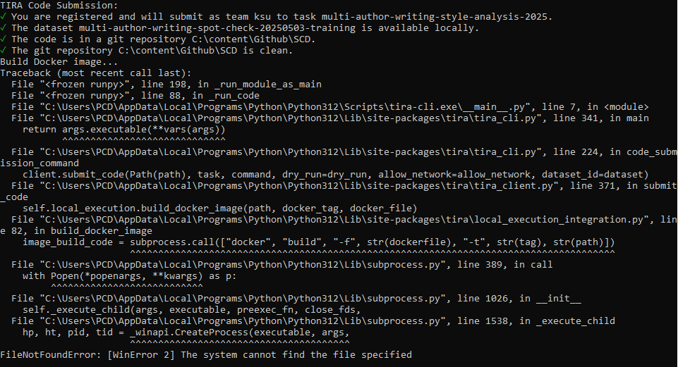

We are planning to submit our solution using the “code submissions” option. We have followed the outlined steps for setting up the TIRA CLI. However, when running the command tira-cli verify-installation, we encountered an error related to Docker, even though our intention is to submit our code directly without relying on Docker containerization.
Furthermore, when attempting the code submission using the command tira-cli code-submission --path my-submission --task multi-author-writing-style-analysis-2025, we receive an error, despite having a Dockerfile, requirements.txt, ourcode.py, and model.pt in our submission folder.
We would greatly appreciate your guidance on how we can proceed with our submission without needing to download and utilize Docker. We have encountered difficulties with Docker in the past, which unfortunately led to system issues, and we are hesitant to repeat that experience on our new machine.

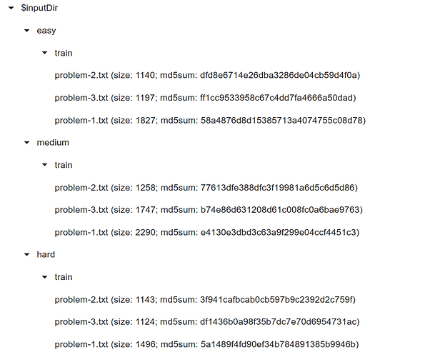

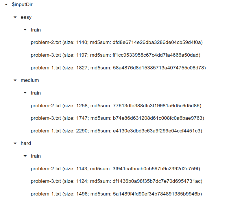

Dear Abeer,
Thanks for reaching out!
Each dataset in TIRA has all the three subdatasets embedded.
The multi-author-writing-spot-check dataset is intended as a tiny dataset that you can use to verify that your solution produces valid outputs, it consists of three instances for each of the three datasets.
This is the dataset structure:
The multi-author-writing-spot-check is intended as the test dataset (I renamed the dataset now to multi-author-writing-test as this was indeed confusing), it has the same structure:
Very nice that you go for code submissions.
We currently need docker for code submissions, but a good way to resolve the problem that you have would be to use Continuous Integration. Would it be possible for you to upload your code to github (can be a private repository) and invite me (my Github account is mam10eks) to the repository? Then I could set this up, I think this would be a good solution as this way you do not need Docker on your machine.

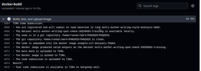

Dear Abeer,
Thanks, I received the invitation and will take a look tomorrow, thanks!
Dear Abeer,
I now configured the Github action in a fork and have re-organized the baseline so that it is similar to how you have organized your code (i.e., one submission per subtask).
The github action runs smothly (I tested it for my own account in my fork of the repo):
I think this should resolve the problem from above and we can continue the discussion in a private chat.
