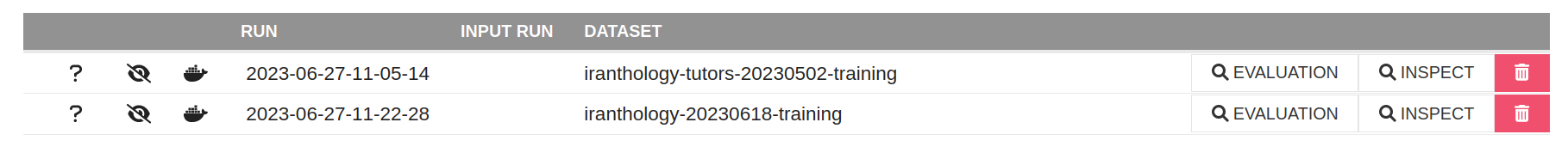

We still aren’t really sure why the dataset names in the table are different from the ones we select when we create a run:
Is iranthology-tutors-20230502-training corresponding to the dataset iranthology-tutors? If so, what dataset is the second one? Would that just be iranthology?

Yes, this is something that we have to improve in the UI, you are right. The table there adds a suffix to the dataset name containing the version of the dataset (i.e., this is the timestamp and the -training).
