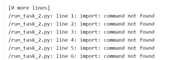

As we tested out our docker container submission on our own, the docker container ran the python script as an entry point just fine, but as we submitted our docker submission via TIRA, it ran into the following issue running the script:
error_tira
What could be the issue to this?

Ah, yes, indeed, now that I see your entrypoint, it is clear to me that the entrypoint works but the software not.
In your entrypoint, you execute the program python, which has /run_task_1.py as parameter (and python in that case runs your script).
But the command that you specified was just /run_task_1.py, so it thinks that this is an executable program. You can resolve this by either changing the command that is executed, e.g., to python /run_task_1.py, or (and I think this is the better approach) specifying the Shebang of /run_task_1.py and make this executable.
