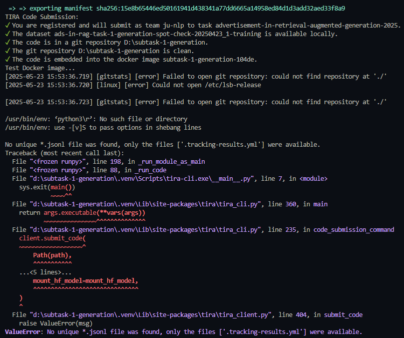

Can’t upload the baseline model currently.
The following is the error I am facing:-
Can anyone help me out?
Edit: Currently the run uploads work so I am uploading using that for the Task-1…but since Task-2 needs code submission so, any help is appreciated.
Dear arka,
Thanks for reaching out and for participating in the task!
The problem is that the software did not produce valid outputs.
The reason is:
python3\r: No such file or directory
This might be a problem with the line breaks in windows vs. line breaks in linux.
The submission in the baseline uses the shebang, and there the line break is wrongly interpreted.
You should be able to resolve this by changing the entrypoint of the docker image.
I.e., from:
ENTRYPOINT ["/generate.py"]
To:
ENTRYPOINT ["python3", "/generate.py"]
(the difference is that the first entrypoint tries to read how to execute the file from the file itself, and there it interprets the non-linux linebreak \r as part of the executable, this is resolved in the second entrypoint where we directly specify that it should run python3.
Does this help resolve the problem?

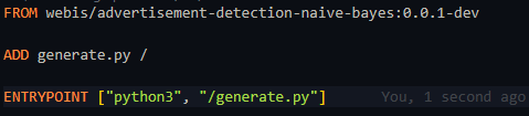

Hi Malik,
Nope, this doesn’t seem to help. Hitting the same error as before
Also, adding the updated docker config
Regards,
Arka

    sys.exit(main())
  File "d:\subtask-1-generation\.venv\Lib\site-packages\tira\tira_cli.py", line 360, in main
    return args.executable(**vars(args))
  File "d:\subtask-1-generation\.venv\Lib\site-packages\tira\tira_cli.py", line 235, in code_submission_command
    client.submit_code(
        Path(path),
    ...<5 lines>...
        mount_hf_model=mount_hf_model,
  File "d:\subtask-1-generation\.venv\Lib\site-packages\tira\tira_client.py", line 410, in submit_code
    metadata_uuid = self.upload_run_anonymous(tmp_dir, dataset_id)["uuid"]
  File "d:\subtask-1-generation\.venv\Lib\site-packages\tira\rest_api_client.py", line 1032, in upload_run_anonymous
    raise ValueError(message)
ValueError: Failed to upload to TIRA, got statuscode 502. Details: <html>
<head><title>502 Bad Gateway</title></head>
<body>
<center><h1>502 Bad Gateway</h1></center>
<hr><center>nginx</center>
</body>
</html>
