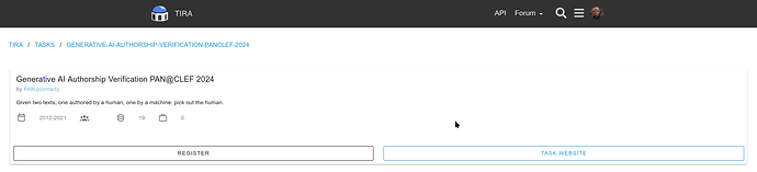

First, you must register to the task that you are interested in via the register button:
As soon as you have registered, you can click “submit” and then you can decide how to upload, e.g., via a Docker submission or a code submission, which then gives you a step-by-step guide:
