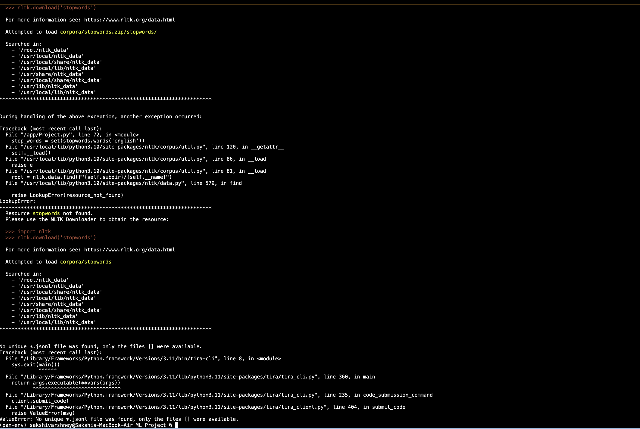

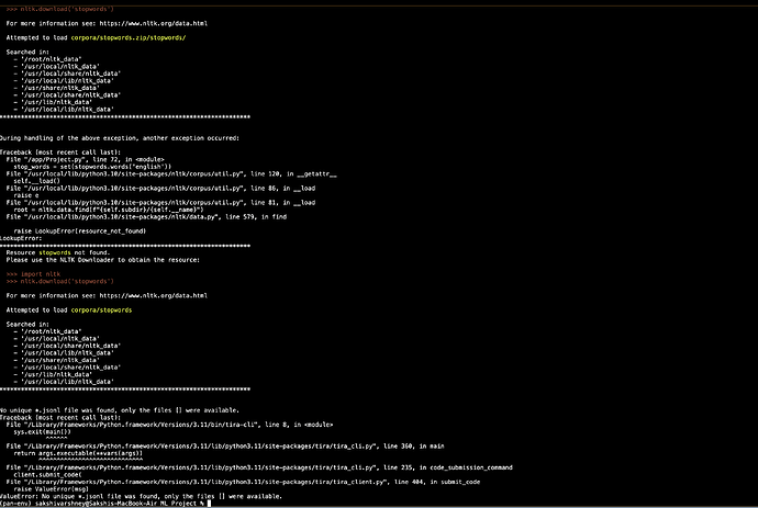

Hi
still getting errors.
i’ve attached the error for your reference
the error message Resouce stopwords not found indicates that they are likely not installed in the Docker image.
Could you please invite me to your github repository (my account name is mam10eks), then I can help to finalize the submission.
Thanks in advance!
