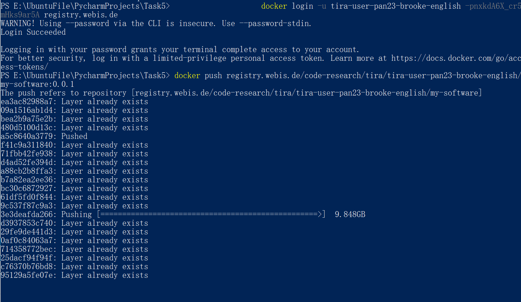

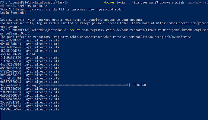

Thank you, I would have a try maybe today or tomorrow.
Is there any limitation on the file size of each docker layer?
I copied all the models into the image, which has a total size of 10G, and then the largest docker layer got stucked in the end when pushing.
should I keep waiting?
Dear Shirui,
Yes, adding all models to the image is correct!
There is no upper limit for the size of the docker image, we only have a limit of 12GB per layer (and I can further increase this limit if required, so please do not hesitate to contact me in case you have larger layers).
I hope your upload was successful in the meanwhile?
I am not exactly sure what the docker registry does at the end of pushing a layer, maybe it calculates a checksum, which maybe takes a short moment of time when the layer is 10GB.
But I would hope in the meantime, your upload finished successful?
