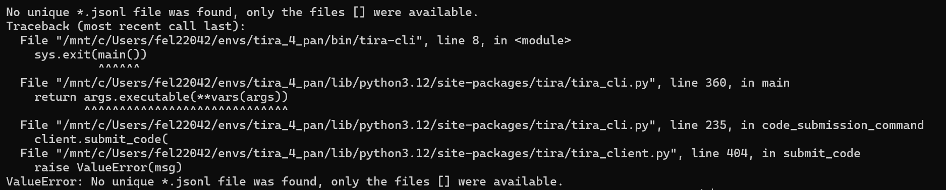

However, after that I receive the following error: ValueError: No unique *.jsonl file was found, only the files were available. (see attachment).
I would be more than thankful if anyone could provide a hint how to resolve that issue.

This error message could indeed be improved a bit, the message was intended to say that the software was expected to produce a jsonl file in the output directory, but there were no files in the output directory. I.e., there is very likely an error earlier in the log that explains what failed.
Does this help you? You can also invite me to your git repository (my account is mam10eks), then I can try to help to solve this.

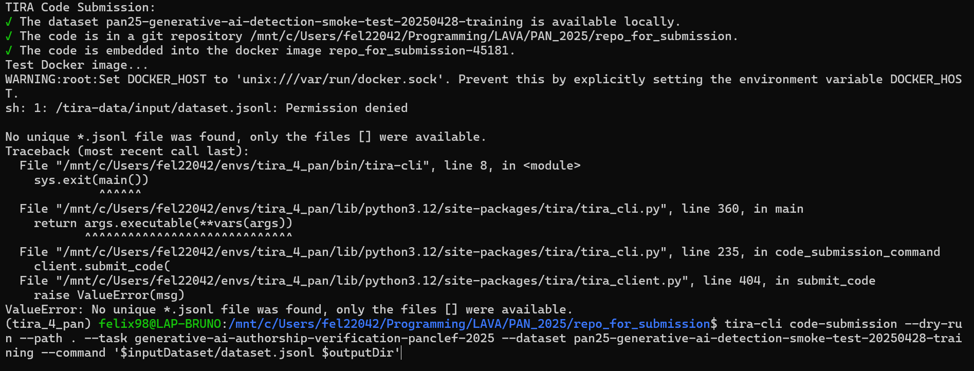

I am enclosing a second screenshot. It shows at the bottom the command that I executed and on top the received error. I tried a slightly changed command as before but ended up in the same error.
Maybe this sheds some more light on it.
Perfect, this helps indeed.
It tries to execute /tira-data/input/dataset.jsonl as a binary, but this file is not executable.
The part
--command '$inputDataset/dataset.jsonl $outputDir'
describes which command is executed within the software (where $inputDataset points to the directory where the input data is mounted). Hence, the command above fails, because it tries to execute the input data.
This parameter should rather go in this direction:
--command '/path-to-my-script.py $inputDataset/dataset.jsonl $outputDir'
E.g., for the Generative Authorship Verification baseline, the flag looks like:
--command '/usr/local/bin/pan25-baseline tfidf $inputDataset/dataset.jsonl $outputDir'
Does this help to resolve the problem?

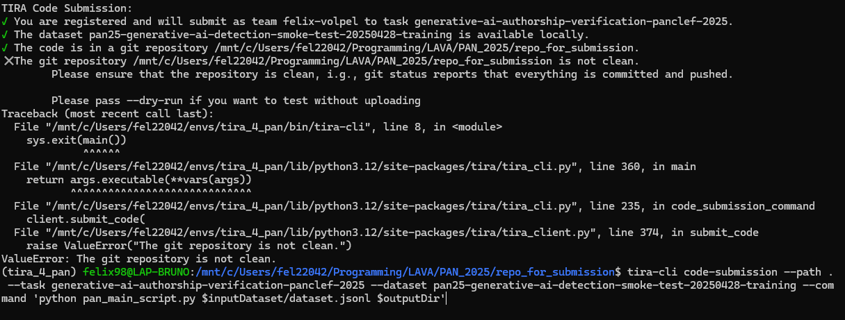

I have tried the code-submission. However, depending on the respective tira command I execute, I run into one of the following errors.
First error: “git repo is not clean”.
However, I can ensure that it is. My git status shows nothing to commit and a clean working tree.
Do you have any idea how to fix this?

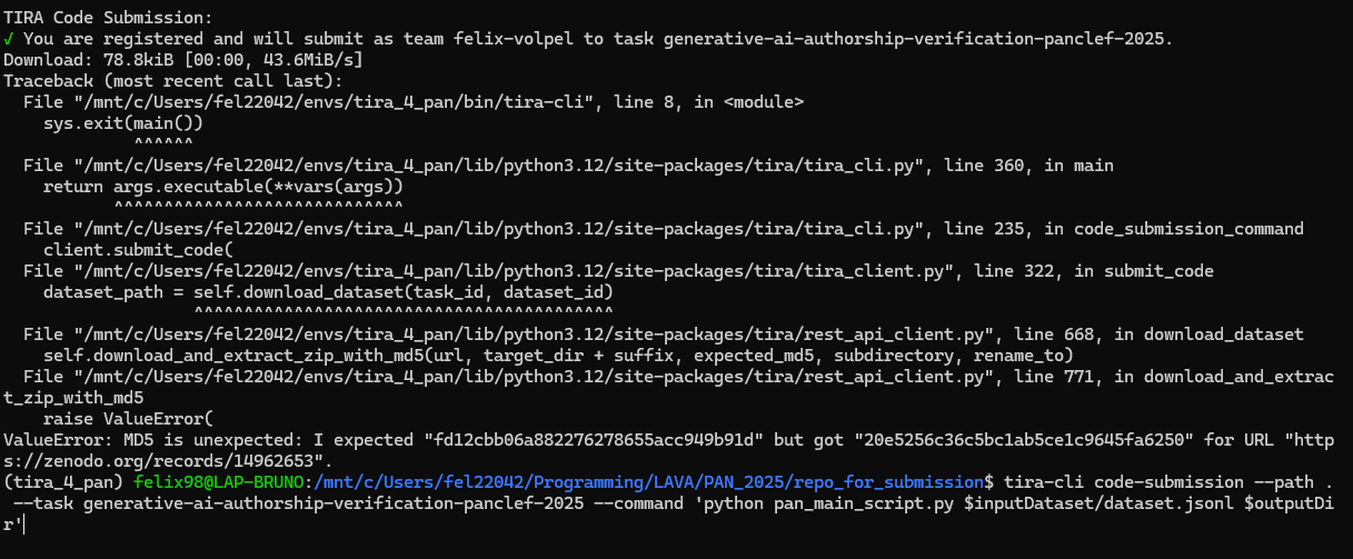

If I exclude the --dataset from the command I receive, however, and MD5 error like this:
Hi Felix,
Sorry for the MD5 error, the problem here is that the dataset is not available on Zenodo anymore, this causes the MD5 error. We updated our database, but you likely have the old URL still in some local cache. Could you please run rm -Rf ~/.tira/.archived/? This should resolve the error.

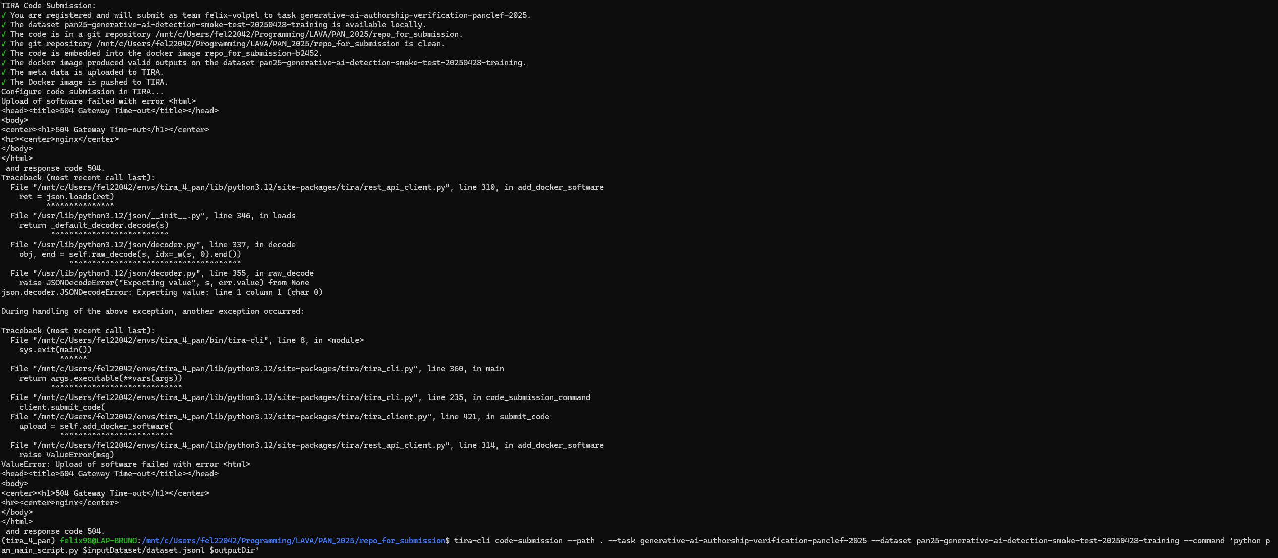

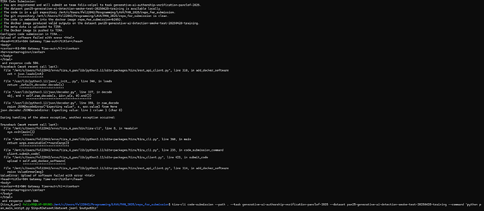

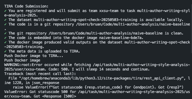

Unfortunately, it seems that shortly before the final submission I run into another error. I post a screenshot here.
Do you have any idea?
Hi, this is a gataway timeout of the server (calling the kubernetes pods), there are (because of the deadline), some spikes in the load.
I think it is fine if you just re-run the command, the layers that are already pushed are not pushed again, so it should get better :slight_smile:
I also experienced this a few times yesterday, but when I tried it a second time it usually worked.
If this persists for you, we can have a more detailed look, but for the moment I think just trying this a second time should do it.

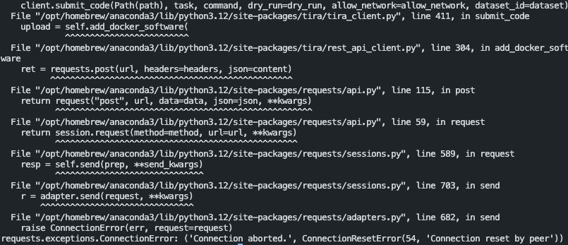

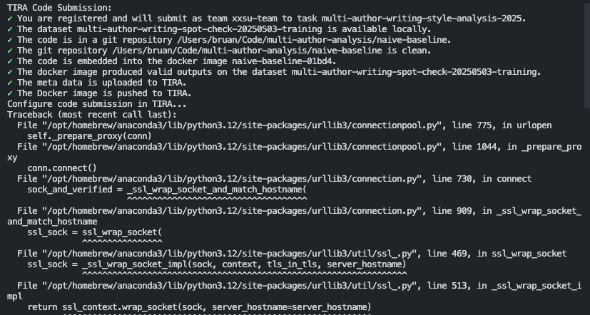

but now I run into another error ,That is my screenshot.
could you told me what happen? Thank you !!! :face_with_peeking_eye:
this might be a short hiccup, as the servers are currently under load.
Could you please try again?

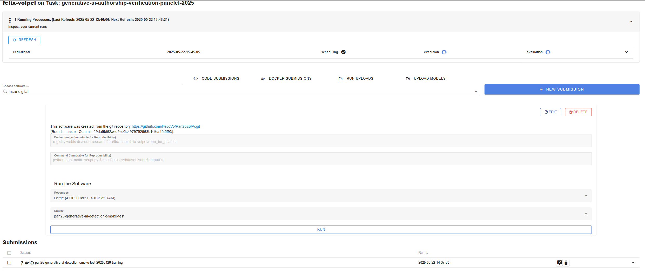

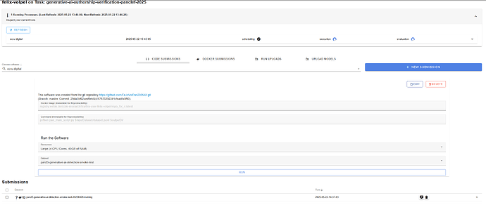

I was able to make a submission. However, when I try to run it on the server on the smoke test dataset the process is scheduled but the execution is trapped in a loop. It does not seem to finish.
Is this because of the current load or are there any issues with my submission?
Here is a screenshot.
